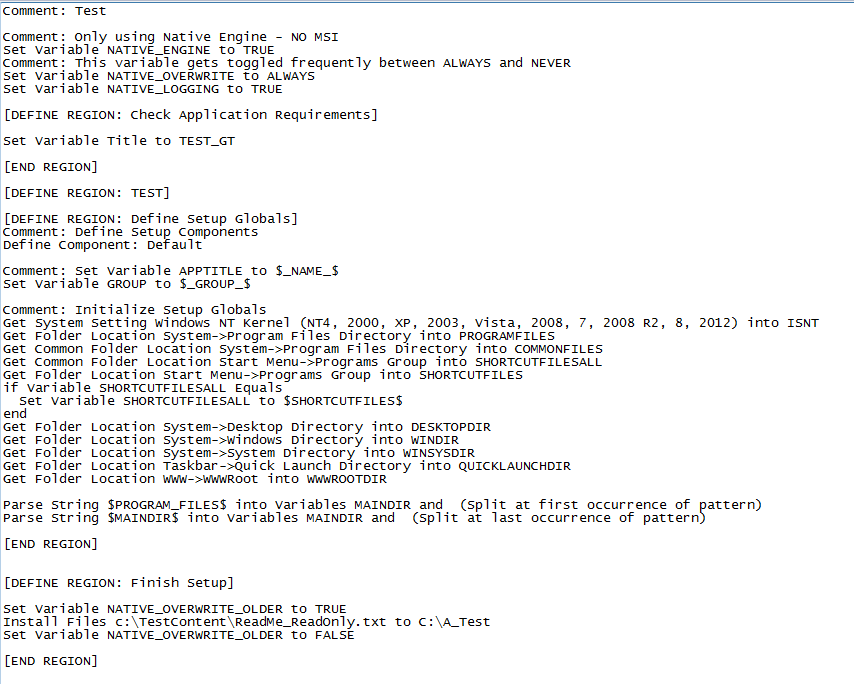

We are trying to install/update files as read-only on target system. Corresponding check-box is set in InstallAware, but file is deployed as read-write. If the file (read-only) exists on the target system prior to installation, InstallAware renames it as<FileName>.0 (oh yes, mystery solved...). Note: this file is not removed on reboot as you've mentioned in viewtopic.php?f=2&t=10412.
How can we make InstallAware install/overwrite file as Read-only without any old files remain as *.0 on target system? I've done small project to demonstrate, see attachment.
- IA_Sample.png (44.85 KiB) Viewed 11137 times

Dear Galina,
#1 - for what concerns the "Read Only" attribute via Install Files command, unfortunately the attribute doesn't get applied as expected. The issue is limited to NATIVE ENGINE only and I'll report a note about the problem to our dev team. As workaround you can run the "ATTRIB dos command" to set the read only attribute for the target file (please see attached project).
#2- regarding the "<FileName>.0" that doesn't get removed on re-boot, this behavior seems to be limited to some OSes. For example I have been able to replicate the issue on WIN 7 while on WIN 10 it works fine. Even in this case, I'll report the problem to the dev team. As workaround, the only option is to force the deletion of such files.

Re: Read-only attibute not set via InstallAware script
I'd like to add one more item to your list. It looks that InstallAware IDE changes the source file attribute just by compiling the script. Other words, if we have source file on the network, marked as Read-Only (example H:\A_Script\App file\ReadMe_ReadOnly.txt) and reference the file in the script via "Install Files", compiling this script via InstallAware IDE will change attribute of this file to Read-Write. You can use my original example to replicate this behavior. Just change \App file\ReadMe_ReadOnly.txt to Read-only.
It is a problem for us since InstallAware compilation changes the source files attributes (without notifying) and indirectly affects our deployment process.
