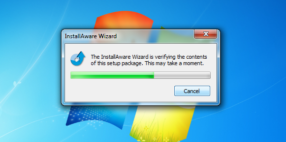

after updating to X3 it seems there are non localizable messages.
Using single file build of a german translated project we get the following when starting the result:
I did a full search on the project folder and also the full(!) C:\Program Files (x86)\InstallAware
and could not find it.
Where can I translate this message?

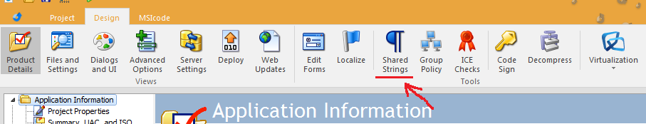

Postby FrancescoT » Fri Sep 18, 2015 11:06 am
Dear Anja,
those strings are part of the "Localized Shared Strings".
http://www.installaware.com/forum/viewtopic.php?f=2&t=5048

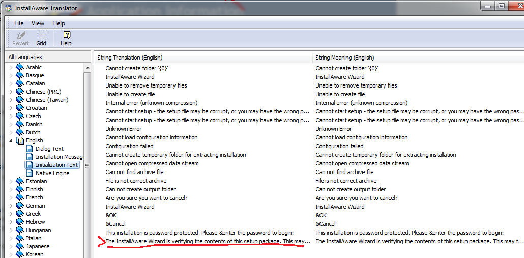

Postby FrancescoT » Mon Sep 21, 2015 11:45 am
Dear Anja,
nothing has been changed on X3 for what concerns "shared strings".
As you can see from the above screen-shot, that particular string is still there.

Re: Non localizable messages
Postby FrancescoT » Tue Sep 22, 2015 9:11 am
Dear Anja,
the default sentence displayed by the initialization dialog is;
"The InstallAware Wizard is verifying the contents of this setup package. This may take a moment."
I can only suppose that for some reasons, you used a custom and different string translation, which is not part of the default shared strings.
