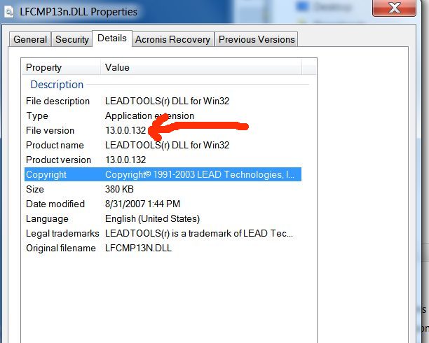

Yes... every file has a date/time stamp but...
Every DLL or OCX also has a version number associated with it. i.e. just like the version number of Installaware, etc.. See attached image as an example.
When Installaware makes sure that only newer DLL or OCX files are installed... how does the software determine that... by looking only at the date/time stamp of the file OR by comparing file versions.
The reason I ask is that the only 100% reliable way is to compare the file versions since date/time stamps can sometimes change.
Thanks... George

Re: Does IW check for file versions before writting a DLL or
Dear George,
it's the version (if present) that takes the precedence during the comparison process. The date stamp is used when the file doesn't include a valid version number.
GREAT... thanks.
