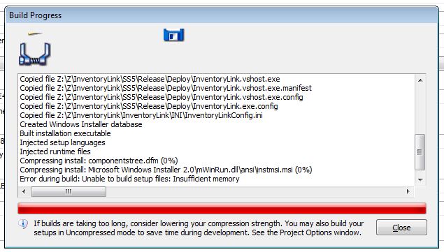

Hi guys. This has been happening to me randomly since I bought and installed x2 in May of this year (currently running Build 4.03.15). Nothing short of a complete restart of the development machine "fixes" it. Its turning into a real PITA. Any suggestions on how to fix it? This machine has more than enough horse power to run your software... thanks in advance
"Error during build... Insufficient memory"

Dear BigJ,
some improvements on this side was introduced in IA X2 with the release of version 19.08 (the version can be checked in Add Remove Program).
Anyway, please consider that the highest compression level makes extensive use of system resources and under some circumstances, these could not be Always available in the same way. This could explain why the error seems to occur randomly.
At any rate, you can also try to lower down the compression level in project settings (SHIFT+CTRL+F11).
