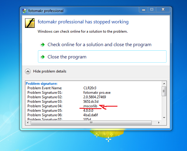

Dear Michael,
for what I see is a digital signature issue with the "mscorlib" file.
Probably you try to install such file, instead to use the appropriate VC RTM package installer.

Hi. Could you please be more precise? I can confirm that the mscorelib is not installed separately. The certificate I use is valid until Nov. 2016. Why would a single file setup terminate and the same but extracted setup install? BTW I'm using Win10 Threshold 2

Dear Michael,
I didn't say that your signature it's not valid.
For what I can tell, it seems that you are applying your signature to a file which is already signed.
However without having your project, I can only suppose this!
For test purpose and to verify if the problem has a signature cause, you may try to build your package without applying any digital signature.
Then run the package to see if something changes.
