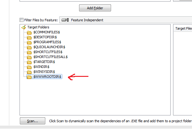

Dear Livechatpro,
in reality such variable should be already available. You can check for its presence within the File page of your project (Design view).
Anyway if it's not, in the File page right click the "Target Folders" node then; Add System Folder -> WWW->WWWRoot.
