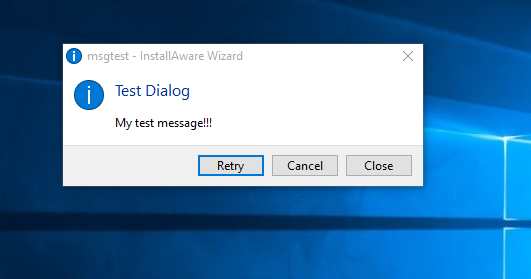

Seems like I had a misconfig there which caused OK-button to show up. After I corrected the option I got the same
buttons as our customer: Retry, Cancel and Close. Seems that Retry is retry, Cancel is abort and Close is ignore .... Weird ?

I just captured a screen-shot of the "MessageBox" and this should be displayed as below.
Anyway, I'll check for what concerns the "ignore" label with the dev dept.
