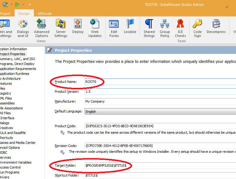

1- Define the target directory in the "Project Properties".
This by default is defined as; $PROGRAMFILES$\$TITLE$, you should change it to $PROGRAMFILES$\ROOT6 in case your "Product name" differs from "ROOT6". Alternatively, leave this as by default ($PROGRAMFILES$\$TITLE$) and enter ROOT6 with the "Product name".

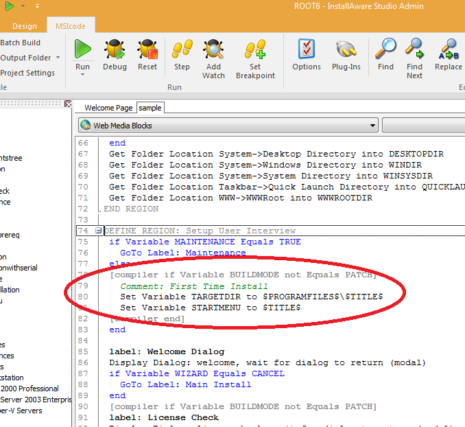

Due the above settings, the TARGETDIR pre-defined variable will be initialized accordingly in the main script (MSICode view).
The TARGETDIR pre-defined variable is also used by the "Destination Dialog" to display the default install path at setup Runtime (eg. "C:\Program Files (X86)\ROOT6").
