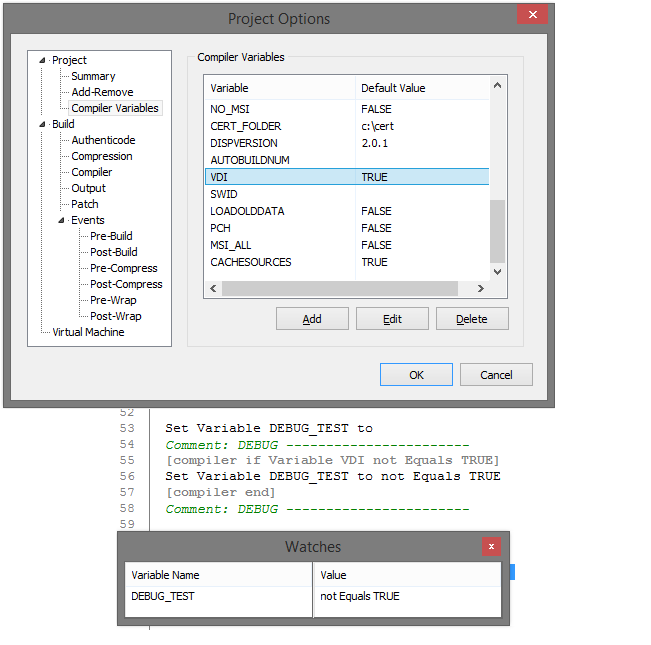

Installware X3, Win8.1
The attached screen capture shows that DEBUG_TEST is getting set to the value within the [compiler if Variable VDI not Equals TRUE] even when the compiler variable VDI is defined (in Project Options->Compiler Variables) as TRUE. DEBUG_TEST (at the breakpoint behind the Watches window) should show either empty (or maybe "variable not defined"). All the other [compiler if Variable VDI not Equals TRUE] blocks in this script (the main script) also incorrectly execute the code within the compiler if Variable... block.
What am I missing?

- IfCompilerVariableFailureCapture.PNG (37.43 KiB) Viewed 6695 times

Good morning, Erich.
I took a look at this and I've attached a minimal project. I tried setting a compiler variable, VDI, to both TRUE and FALSE and things seem to work okay for me. I tried to replicate similar code as you provided. Could you try running my project and see if mine works differently to yours?
The only thing that puzzled me is why you set the DEBUG_TEST variable's value to the literal string "not Equals TRUE". For sure I used the same value in an "if" statement but if I wanted to use it elsewhere I could see myself possibly checking for "Not Equal TRUE" which isn't the same as "Not Equals True". Is that what you had in mind? I ask because I would normally use values 0 or 1 in my "if" statements but that's just my preference.
I mention this in case you might be tired and overlooked a syntax problem.
I also admit that I might be tired and overlooked a syntax problem as well.

Thanks for the quick reply.
Yes, your minimal test project worked as expected. So I reloaded the project exhibiting the reported behavior and upon recompiling it, I am now getting "Insuffient COMPILER VARIABLE END statements" error.
I loaded the main project script's .txt file into NotePad++ and performed searches for "[compiler if Variable" and "[compiler end" and found the counts for both searches match. I manually re-examined the main project script along with all the smaller scripts in the InstallAware IDE and found no [compiler if Variable ...] statements that lacked a corresponding [compiler end] statement.
My question now is: Can [compiler if Variable...]/[compiler end] statement pairs be nested if target compiler variable of the inner [compiler if Variable...]/[compiler end] pair is different than target compiler variable of the outer [compiler if Variable...]/[compiler end] pair?
