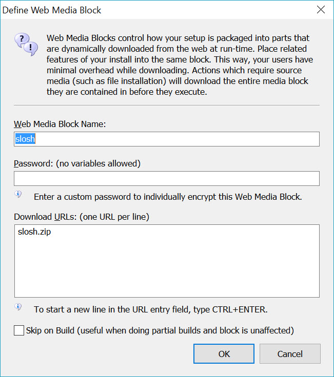

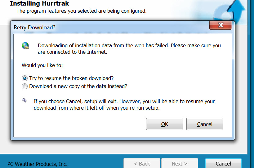

I must be dense but I guessed at how to define the web block and did the following
I renamed the .7zip to .zip and tried to execute and it failed with the following.
What am I doing wrong?
George
George
Re: .7zip files causing problems for me
Dear George,
it doesn't work of course!
With the "Downlod URL parameter" of your Web Media Block you only entered the file name and not its URL (...eg. "www.mysite.com/downloads/slosh.zip").
