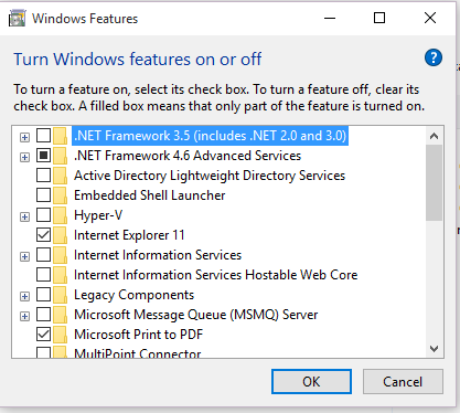

I just updated to IA X4 in the hopes that it will allow to enable .NET 3.5 during the installation.
We are installing an older application that is relying on .NET 3.5 on Windows 10 but it will not enable this feature even though it is selected in the Application Runtimes. Other runtimes like Visual Studio C++ Runtime 10.0 is getting installed no problem.
Is there anything I am missing what I need to do?
I understand that in Windows 10 you need enable this feature through the Windows features and not download and install.
So is there a way in the install compiler to do this?

If you expand the node you selected in your screenshot does it list the features you require? I'd like to know if it contains what you want enabled?
