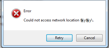

I am working on resolving an issue one of my clients has with my InstallAware install when they tried to push the install via SCCM as the System account. They need to use the System account as their users do not have permissions to install software. The client is installing the software silently.
We can test this scenario using SysInternals PSTools utility PSExec.exe to run a cmd.exe prompt as the System account and run the install from that cmd prompt.
My first problem was the Destination dialog in the Aero theme using a Shell control. This was resolved by removing the shell control and using a Browse button similar to the Official dialog scheme. This seemed to work until I rebuild the install and got strange error message dialogs.
This one is very short but I have had some that list a whole lot more:
This is a longer one, and I had one where the entire dialog box was a jumble of unicode\Chinese characters.

My issue was the actual dialog theme I was using - Aero. The Location dialog where I choose the install location uses a "shell control" showing an Explorer-like tree view for selecting folders. My older installs (which used Official dialog theme) just used an edit field and a Browse button. I had to modify the Aero dialog to use a Browse button like my older installs.
What was happening was that the shell control cannot be initialised as under the System account as there is no "access to Desktop"; this caused the install to fail.
