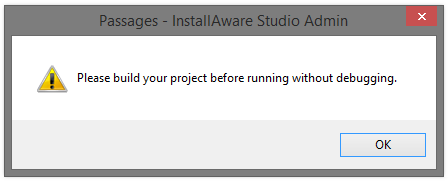

I build the installer project (Single EXE) successfully, and now, after I have begun dual signing the components using the IA Build Events according to InstallAware's published instructions, I get this message every time I click the Green Arrow on the IDE to run the setup without debugging, (or after making a Debug Build) I click on the debugger. In short, I can no longer run a setup, with or without debugging, from within the IDE.
(NOTE: Before dual signing via the IA build events, I could build an setup and them immediately run it without debugging as described above without this dialog box popping up).
What has changed? Did I miss something in the Release Notes?

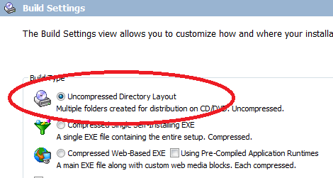

I don't believe your problem is caused by the defined build events.
I suspect instead that the build mode defined with your project doesn't match the effective build produced.
For example;
- with the project the build mode is defined as Uncompressed:
- but the build gets started using one of the following menu:
- finally if you try to run the generated package using the Green Arrow, of course you will receive the following warning:
For example;

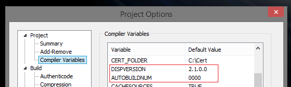

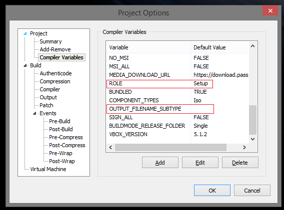

Thanks for looking at it but the compiler variables you listed as being the problem (#TITLE#_#OUTPUT_FILENAME_SUBTYPE##ROLE#_v#DISPVERSION#-#AUTOBUILDNUM#) all have default definitions (see screen caps attached)
NOTE: According to IA documentation, #TITLE# is an IA Pre-Defined compiler variable set to the value of the Product in the Project settings and so I assume that is why it doesn't show up in the list of Compiler Variables. Is that correct? Or do I need to explicitly define a compiler variable named TITLE and set a default value for it?
Why would these default values not be used when running from the IDE after building it in the IDE?

All your compiler variables are defined correctly and used properly. So how these are used to generate the output filename it's absolutely correct.
However all these variables, because are compiler variables, can be only resolved during build time. In other words, once the build process is completed, the IA IDE will be not able to resolve such variables and consequently, it'll be not able to run the generated package. It tries to run a file which is "literally" called "#TITLE#_#OUTPUT_FILENAME_SUBTYPE##ROLE#_v#DISPVERSION#-#AUTOBUILDNUM#.exe" ... and of course such file doesn't exist.
Finally and if you want to run the package from IA IDE, you may "temporarily" replace them with a literal file name or to leave the field blank.
Unfortunately in this case, it doesn't exist a different workaround that can be used.
I'll check with our dev team the possibility to have this feature with future product release.
