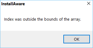

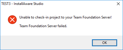

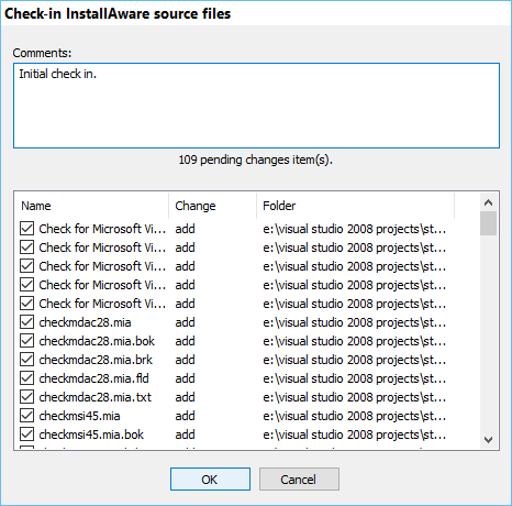

I configured IA to use our Team Foundation Server as the source control provider, when I tried the first check in, I got the following error message:
Index was outside the bounds of the array.
then follow by this message:
Unable to check-in project to your Team Foundation Server!
Team Foundation Server failed.
Before all this, to connect to my TFS, I had to create a workspace with the same name of my computer name and mapped the source control folder to the local folder where my IA .MPR files are.
Source Control Folder: $/InstallAware Projects/TBR Utility
Local Folder: e:\visual studio 2008 projects\strataframe\thombiller projects\ia projects\TBR Utility Setup\TBR Utility
I am using TFS 2015 (Update 3).

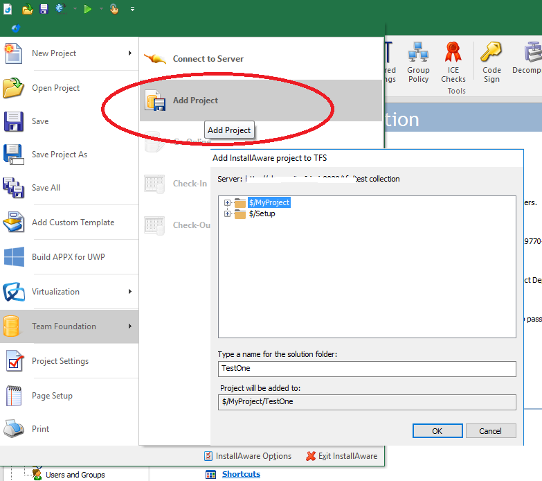

Honestly, I don't see any issue.
How did you add your IA project to TFS the very first time?
Please note that the TFS team project must already exist (this is usually created via Team Explorer) then the IA project must be added from IA IDE.

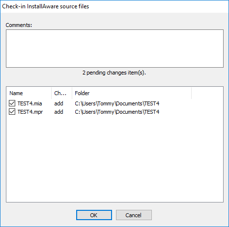

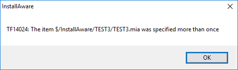

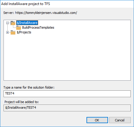

WHen I do that and have selected the new project and enter TEST3 in the box for solution folder name I get these errors
tommykjensen
Posts: 29
Joined: Fri Jan 16, 2009 11:56 am
Location: Denmark
Re: IA TFS Check in issue...
Postby tommykjensen » Wed Feb 01, 2017 1:53 pm
Sorry order. This is how I added the project
ia 1.png (9.52 KiB) Viewed 14139 times
ia 2.png (6.77 KiB) Viewed 14139 times
