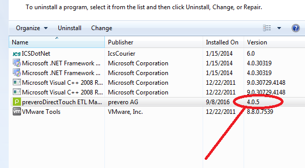

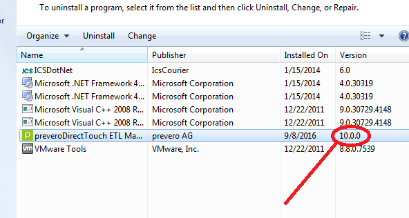

I am not able to replicate any of the problems you reported and please note that I used the compiled SETUP.EXE included with your Archives.
In all honesty, I don't know if you had such issues when running the installers on a particular system that may have a specific configuration. You didn't specify anything about this. At any rate, I tested both packages on a Win 7 X64 system and both get installed fine for all users!
Furthermore, I used a limited user account to test the installers (UAC Enabled) and for what I see, both package get correctly elevated as expected.
For what concerns the product versions, these get properly reported under Add Remove Program.
Please note that under ARP the version number is Always limited to "major.minor.build", due the fact that Windows Installer uses only the first three fields of the product version (If you include a fourth field in your product version, the Windows Installer ignores the fourth field).
For what concerns the version number reported by the setup file, this will be Always reported as "major.minor[.build[.revision]]" or "major.minor[.maintenance[.build]]" (four fields format). So having "4.5.0" as version number, this will be Always reported by the system as ""4.5.0.0" with the respective file version property.

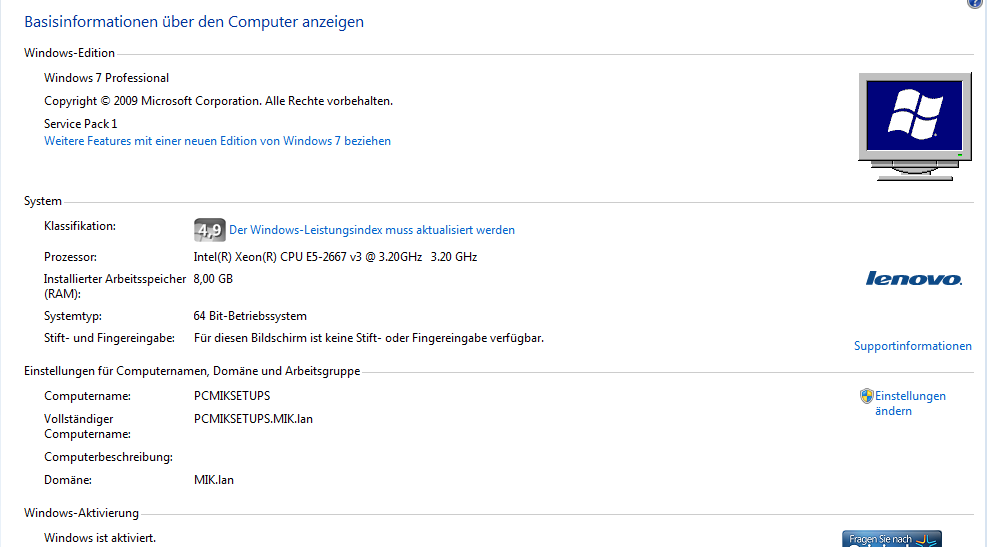

German - Windows 7 64 bit - SP1

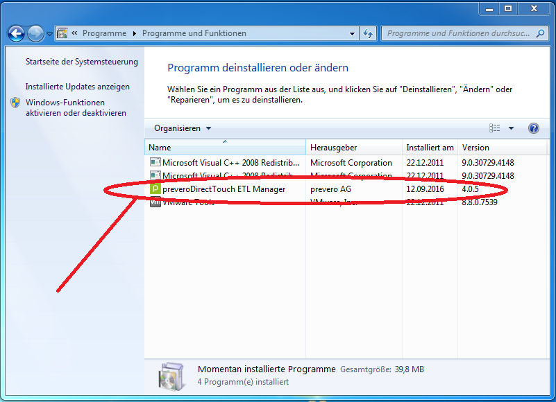

Re: IA18: Error at Install process
Postby FrancescoT » Mon Sep 12, 2016 6:26 am
Dear Heiko,
I just tried to run your installer on a German version of WIN 7 sp1 x64 and I haven't found any problem.
As you can see it gets installed correctly.
Please note that I used a FRESH WIN 7 MACHINE, did you try to install your package on a clean machine (...where JUST the OS is installed)?
I have asked this already, but it seems that you missed my question.
I can only suppose that your problem it's directly related with the systems you used to run your tests, as for example, a conflict due an installed component.
