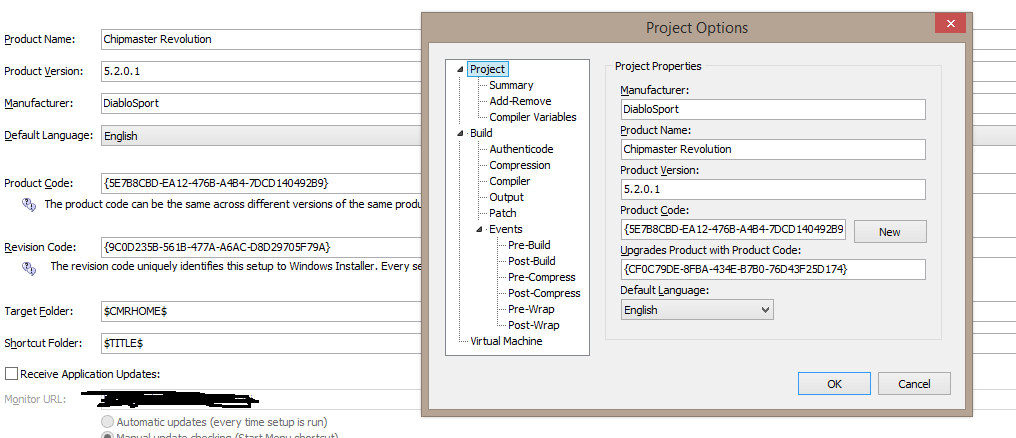

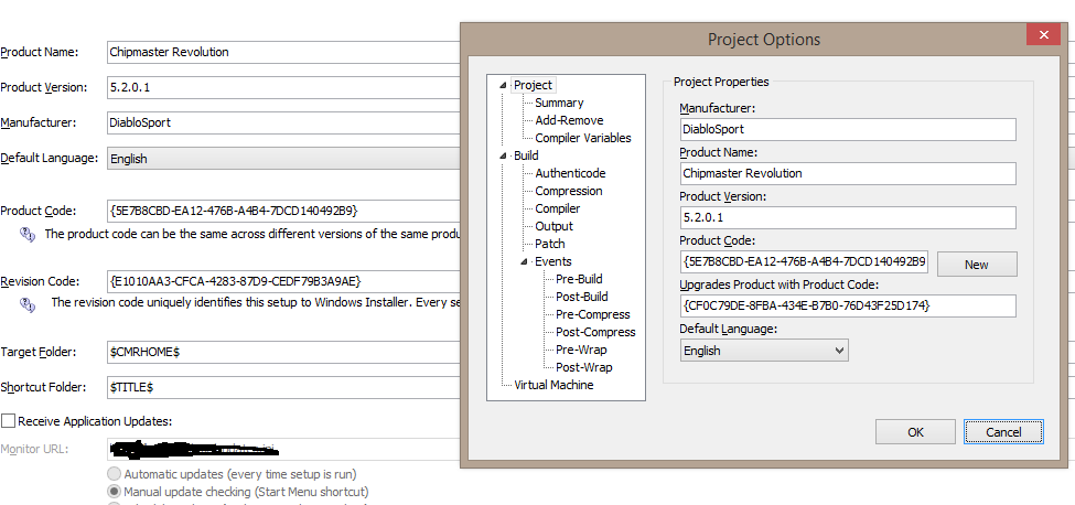

It's the same project. I didn't create a new project so everything is the same except I added a patch reference. The revision code changes on each build because I have that option checked, but it needs to change anyway so that should be ok. I just built everything again and product code, upgrade code and version are unchanged. Same result. See attached screen shots. I did NOT create a new project. There is only one project, I'm using the same project I just added a patch reference.
jim
jim
- PatchFileBuild2.png (49.1 KiB) Viewed 9101 times
- SingleFileBuild2.png (47.94 KiB) Viewed 9101 times

Ok so I made a complete copy of the base project. I checked to make sure the product code and upgrade codes did not change. I added a reference to the full single file build created by the base project as a patch reference in the patch project. I still get the exact same error.

I click generate on the revision code to make sure it changed even though it is set to auto generate on builds.
I save this project by clicking the save button.
Product Name, Product Code, and upgrade code are the same as the original project (as this is a copy of the base project)
I compile new versions of 2 of the C++ programs the installer installs. The file and program versions are changed in the 2 executables. The 2 executables are also a different size from the original versions. I copy those 2 executables into the master files folder my setup project refers to for it's sources.
I click the patch button. It fails with the data in the posts above.
I'm sure it's something I'm doing or my settings, but I can't see what it is. Does the script in the msi page have to have anything special in it or NOT in it for the patch feature to work?
