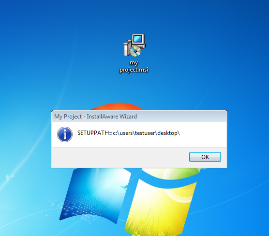

Re: MSI Install
Dear Francesco,
Thanks for your support.
Sorry, it may not sound good, But I'm not getting proper directory values.
Lets us say ...
I have created the Myproduct.msi.
User is going to keep this Myproduct.msi in a directory F:\MyInstaller
Also Myproduct.ini in the same folder.
So within my script how do i refer to this directory F:\MyInstaller ?
I do not know folder name.
My silent installer goint to read this Myproduct.ini
So i need the folder name where my msi is residing.
I tried couple of predefined variables (MSIFILE, SFXFILE, SFXPATH, SETUPPATH etc),
but none of them are giving me correct folder name.
Please advice.
SITL
Lets us say ...
Please advice.
SITL
Re: MSI Install
Dear SITL,
I really don't know how did you test the value returned by the SETUPPATH ... but this is the one that can be to detect the outermost folder containing the executable program or setup database that initiated the installation. Supposing of course, that you are running a Single Compressed EXE/MSI.
As you can see by the attached screen-shot, I tried to run "myproject.msi" from the desktop and the SETUPPATH holds the expected desktop path, for the current user context who executed the package.
