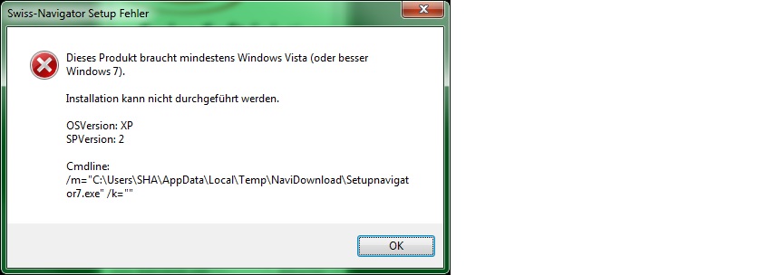

Hi Francesco,
I have done some more testing on a client machine where the problem occurs.
In the script I read the OS and SP level. The OS Level shows as Windows XP, see screenshot below.

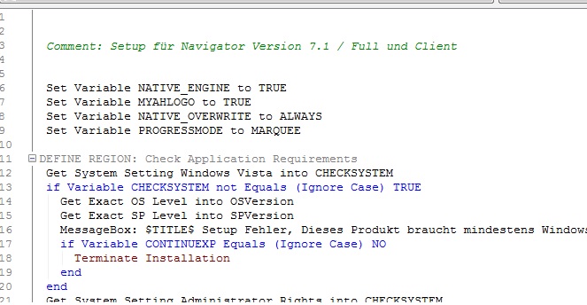

Here are the first few lines of the install script where the problem occurs:
I ran WINVER and this definitely gave me Win7, SP1.
When I start the installation from the commandline it correctly reports Win7. I have now changed the script so the user can still continue, but it's only a temporary solution.
Any ideas?
Thomas
