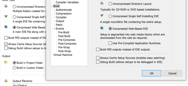

This may be the problem. I was going to the Project Settings dialog and un-checking the Cache option option. However as you can see from the attached screen shot under Build Settings in the tree control it is checked. I had unchecked the box, closed the dialog and re-opened before took the screen shot. I also noticed that if i saved and closed the program it was checked when I re-opened.

Dear Ohmylord,
select your "Cache" option from the "Build Settings" page (Design View -> Deployment -> Build Settings).
Then save your project.
