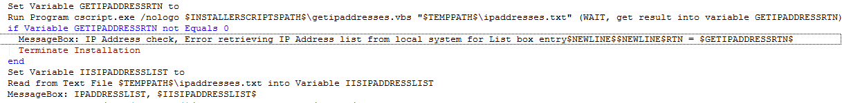

I am trying to add a listbox containing the IP Addresses for a particular system, and wrote a script to generate the IP Addresses.
My installer code runs the script and then reads text file output to a variable, to get the IP Addresses into the listbox.
For some reason, the listbox is only seeing the first entry when I write it to a variable and read it from the MessageBox and the Listbox item list...
Any ideas?
The text file is attached (unaltered) from my testing system as well as a screenshot of my installer code.

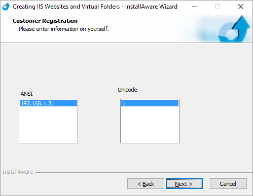

Here's a screenshot of a test Project with Both Ansi and Unicode files...
I would have thought the Unicode File would have looked better... but apparently not..
Something else must be wrong as well.. also?
I am writing a /r/n at the end of the lines.. Is that incorrect as well? I tried with just with a /n only and that didnt seem to help either.
Steven
I have tried Unicode file formatting, and not had any better luck...

- ansi-unicode.png (12.87 KiB) Viewed 5464 times

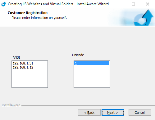

and 2 more points are awarded to the help file.... when I finally "read it all"
.....Prefix the path specified in the Read from File field using the special sequence #READALL\ if you wish to read in the entire file, instead of just the first line of the file. Lines in entire files read this way will be separated using the $NEWLINE$ variable.
Probelm solved. Thank you for your responses to my "noob"-iness
Steven
