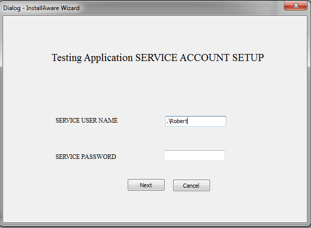

I am trying to install a service with a user name and password. I get the values from a dialog box into servicename and servicepassword
When installing the service I put $servicename$ into the user name box and $servicepassword$ into the password box.
But when I look at the service after install it has the User name that was entered into the user field in the registration box.
I have checked the values just before the install and the values are correct.
username in installing service

I used two new custom variables "SERVICE_USER" and "SERVICE_PASSWORD" to hold the Values passed to the the "Account Name" and "Account Password" parameters of the "Install Service" command. These variables are now declared within the "Define Setup Globals" Region (code line #65) of the install script.
PS
Note that the local ACCOUNTS have to be entered using the form ".\<USERNAME>
It's not necessary to change the location of the project source files ...I used relative paths.
