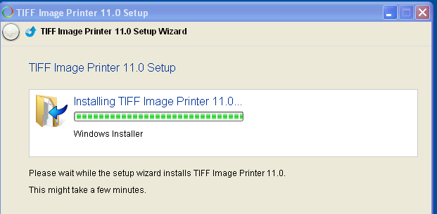

I was able to duplicate this behaviour here using a vanilla project created using the Project Wizard in X6 that only copies a single PDF into the install folder and creates a single shortcut.
When I get to the Progress dialog, the progress meter immediately goes to full and then hangs at that point. The Cancel button is enabled, and I can click it and say yes, cancel the install but it does not cancel. I have to kill it from the Task Manager.
