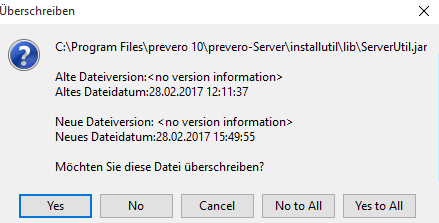

Hello Support,
we are using native_engine and NATIVE_OVERWRITE is set to ALWAYS and NATIVE_OVERWRITE_OLDER is set to TRUE.
Why do we get this PROMPT-Dialog while installing:
NATIVE_OVERWRITE / NATIVE_OVERWRITE_OLDER

I know what is different
The existing file is not a file on target system. With native_engine there is a problem with
command "Install files" when you have the same file in different source folders but you need to install them in the same destination folder.
e.g
install files from ..\..\files\*.* to dest folder => source dir contains readme.txt
install files from ..\..\files2\*.* to dest folder => source dir also contains readme.txt
then the messagebox appears
e.g

Re: NATIVE_OVERWRITE / NATIVE_OVERWRITE_OLDER
...but if it's just this the problem, you may use a different name for one of these "readme.txt" files or you may skip to include one of them.
- Posts: 252
- Location: Konstanz, Germany
it is not possible to rename or exclude because we have hundreds of dll files in 2 source directories and if we install both applications we have that copy problem. We would like to buy X7 but if the bug stilll exists...we can not
