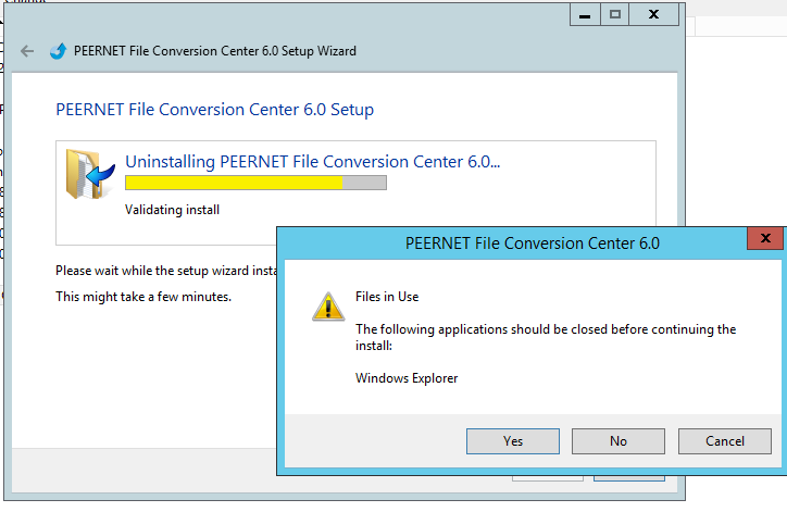

Hello FrancescoT,
Attached is a screenshot. We have been building setups in InstallAware since probably version 10 and we've never seen this prompt with the same setup file. It appeared only after building on InstallAware X6 so I assumed it had to be a change in the new version.

Well, I spoke too soon. The above fix worked for one of my installs that has services but now a similar error is occurring with another program, one where we install a DLL that is a shell context menu for Windows Explorer. After removing the shell context menu, we see a dialog box prompting us to close Windows Explorer - THIS IS VERY BAD as clicking Yes takes down the whole O/S shell.
In our uninstall code, before we call ApplyUninstall I am unregistering the shell context menu dll, and the call does succeed. I can see this when I show the window and run the regsvr32.exe in non-silent mode as in this mode I have to dismiss the dialog before proceeding.
I added the NATIVE_ENGINE settings around these calls but it didn't make a difference.
I am building on X6 (23.01), currently migrating to X6 (23.03) to see if that helps.
My QA team tells me they see this behaviour on he following WIndows platforms:
- Windows 8.1 (x32 & x64), Windows 2012 R2, Windows 10 (x32 & x64) and Windows 2016
- No prompt box on Windows XP – Windows 2012
Any ideas?
Sheri
Any ideas?
Sheri
