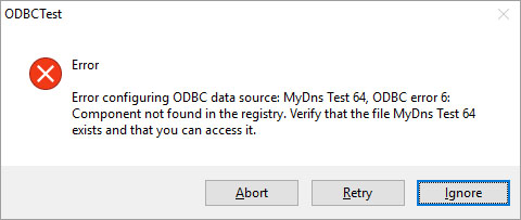

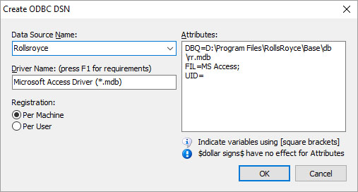

I removed the two DSN entries from the sample file and installed my own. Now I get an error 6.
I have also attached the DSN creation screen. I used the Microsoft ODBC to create the DSN, referenced it in the installer. Created my installation file. Removed the ODBC reference in Windows and then ran the installation file and received the error.

Re: ODBC New DSN not working
Dear John,
I have just updated the "ODBC sample" and this now creates an Access ODBC DSN. It works perfectly on my test machine.
Please note that as recommended with the original project, to run the sample successfully, please verify the presence of the following requirements with the target system;
- Microsoft Access Database Engine 2010 Redistributable
https://www.microsoft.com/en-US/download/details.aspx?id=13255
