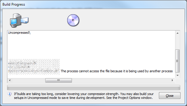

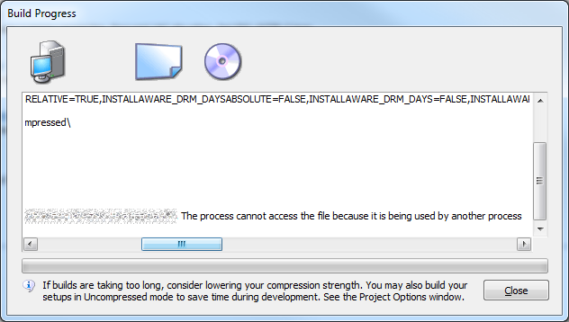

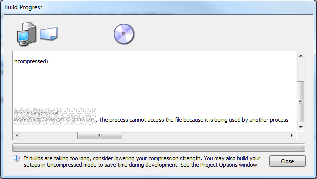

So I have had this random error previously with older editions of IA. But I am getting them more and more often now and my installers are more complex than they were before. They also appear to happen at random points during the build process, usually closer to the start of the build. Images show examples of the build failing but progressing a little further each time.
Running IA as an Administrator does nothing to change this behavior. (While the randomness of the errors might lead to a problem in IA itself, and I do not notice a rise in activity of the various anti-whatever stuff running on my machine, the remainder of this post assumes that IA is not the cause of the problem.)

I never stated that the AV/AM/ADL applications were free of any problems. What I wrote was that a more robust implementation of certain things might be in order. The suggestions offered could even help locate lingering race conditions that might exist in IA. When someone says something like "Frankly, we're already using many heuristics, some of which are trade secrets, to accelerate the build process," it sounds like more places where something can go wrong. And it would follow that the more complex the project, the more these "heuristics" would come into play, and if any bugs exist, the more something is used, the more likely a problem will appear.
This is even more likely if these "heuristics" or any other tests are run near the start of the build, as opposed to being run throughout the entire build process, as that is where we are seeing problems. (After you get past the first 20-30 files or so, the chance of the error happening drops significantly.)
