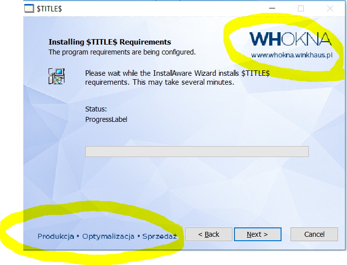

I have a problem in InstallAware X3. When I'm trying to put image to dialog box then program want from me image with resolution 497x360.
That resolution it shows me when I have closed laptop and display pulpit on two monitors, but when I'm working only on laptop without monitors it show's me resolution 650x471 for needed image.
So when I'm putting image in that resolution on individual laptop, and after build I turn it on two monitors this is wrong scaling.
Subtitles are ragged etc.
All displays are in full hd, laptop and monitors too.
I tried to change font from Tahoma to any other bitmaps font like MS Sans Serif.
I tied too change type of object from AeroPngImage to Image without result
[img]Przechwytywanie.PNG[/img]
What resolution or option I should apply.

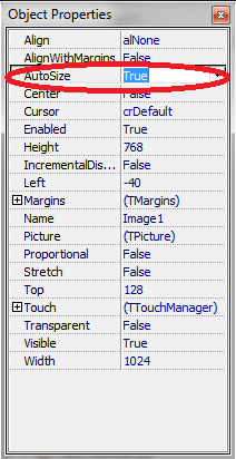

did you try with setting as TRUE the "AutoSize" property of the "Image" control?
This will force the dimensions of the "control" to the size of the Image.

Dear FrancescoT,
I tried to use this option, but images are cropped if I'm using two monitors.
I will only to graduate image in existing ground without lose quality.
Please look at attached screen and compare to image in first post.

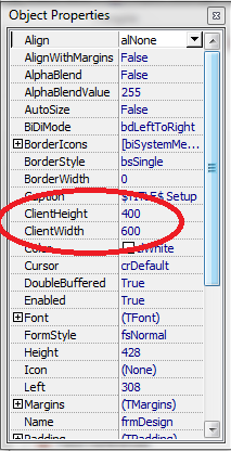

when using a Background image, you have to keep the same "aspect ratio" between the image and client Area of the dialog.
So to make a sample;
- I created a 600x400 Background-image and then adjusted to the same size, the "ClientHeight" and "ClientWidth" properties of the Welcome Dialog.
- for the Background, I used an "AreoPngImage control" and I have explicitly set its size to 600x400.
For what I see, the above approach works fine with any screen resolution (see attached sample).

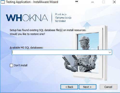

I understand You. I ran dialog box on two monitors and I've been checked area of dialog resolution.
This is 497x360, my picture is in the same resolution, I used too AeroPngImage control with 497x360.
For what I see all is good, but when I ran it on individual laptop it shows me other resolution of area dialog resolution.
For example Yours testing files shows me on laptop needed resolution 800x533 - its other than on two monitors (800x600).
If I'm putting more detailed picture is not looking good. For example please look at attachment

Dear Tomasz,
for what I understand, this is due the "display scaling settings" of your machine. When using a DPI over the default 100%, Images and controls get automatically scaled by the system. For now, there isn't any workaround that can be used to skip the problem. Unless of course, you set your DPI scaling level to 100%.
