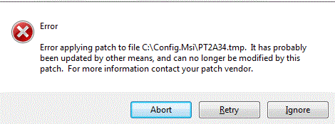

Issue 1. Error applying patch to file C:\Config.Msi\PT5418.tmp (error message is attached)
(this error is very consistent on Win 7, 64 bit OS . Let's consider this as only case.
because on other operating systems, it's very minimal)
NOTE : I'm sure our files are not changed by any other means.
No other instance is running.
just installed the product and
after few seconds, if we try to apply the patch we are getting this error.
and log file is not created. i have specified it as a parameter "/l C:\PatchLog.txt"
Issue 2. For patch, we are using Manual mode & No silent install.
There is a shortcut (My Product Updates)on the start menu,
If the user clicks on it & after downloading the patch, the user has clicked cancel.
And again, if the user tries to run apply the patch by clicking on the shortcut - My product updates,
We are getting the message - No updates are available at this point in time.
Appreciate your comments.
SITL
- UpdateCapture.GIF (12.72 KiB) Viewed 2808 times

Issue 1.
For what I see, it seems that you are not sequencing your patch correctly. The error reports that you are trying to apply a patch to an installed product where;
1- a different patch build have been already applied to the installed product.
If this the case, this is self explaining. You tried to apply a patch where a more recent patch build has been already applied.
or,
2- the installed product version (the specific build of the product) doesn't reflect the "product build" expected by the patch.
If this the case instead, the product reference specified with the patch project, it doesn't match the product found installed. This typically happens when a "certain build of base project" has been used as patch reference, while a different "build of base project" has been then used to install the product.
Anyway for both cases, the error is telling you that your patch is not sequenced correctly.
As I suggested you several times already, please carefully review the following topics. These discuss useful information on how to avoid common errors when creating a patch. Specifically with the first topic, it's discussed how patches have to be sequenced to correctly handle different builds and versions of a product.
http://www.installaware.com/forum/viewtopic.php?f=2&t=9656
http://www.installaware.com/forum/viewtopic.php?f=2&t=8697
