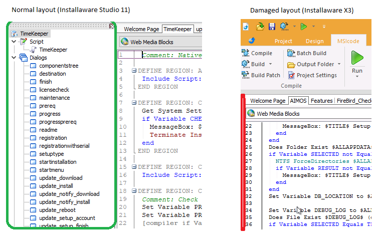

the MSICode tab usually has a panel on the left containing beyond others the list of scripts.
In my Installaware Installation this panel disappeared some time ago after a crash of the IDE.
Now I need to remove a script and it seems not be possible without the left hand panel.
How can I make the panel visible again?

Hello Francesco,
I know how to activate the Project Manager. The problem is that it does not work on the MSIcode tab. I always see the layout from the sceenshots.
In the mean time I've found the solution: I replaced the mia.mix file on the X3 Installation by the file I've had in IA 11 and now it works.
BR
Michael
