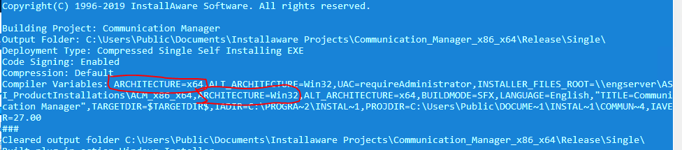

I have a suspicion that the project is set to 64 bit mode, but is then set back to 32 bit mode. I haven't been able to find anything that would do this - and again - this project worked successfully in 64 bit mode using InstallAware X3. No changes have been made other than what InstallAware may have done to upgrade the project. The reason I wonder about the 32-bit mode is that the command line shows the mode set to 64 bit mode and then later shows the mode as 32-bit. Shown in the attached image:
View of output at start of command line build.

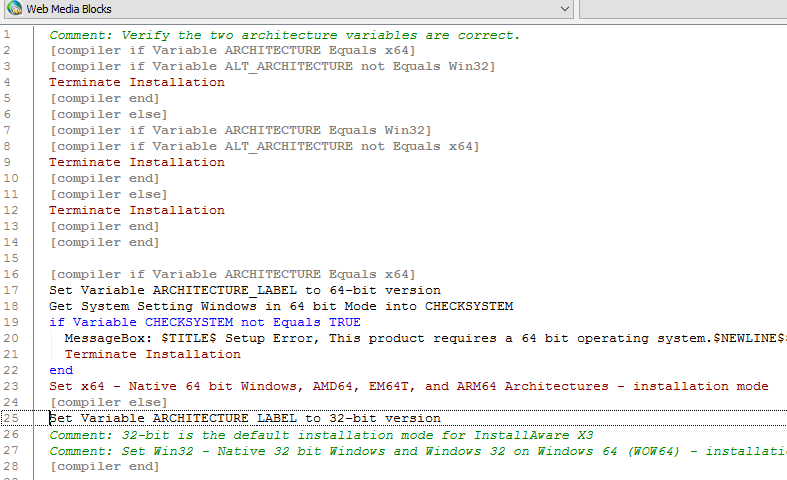

My project is put into 64 bit mode using the msicode shown below. This is the very beginning of the main script. Shown in the attached image 64bitModeSetup.png
msicode script to setup 64 bit mode
