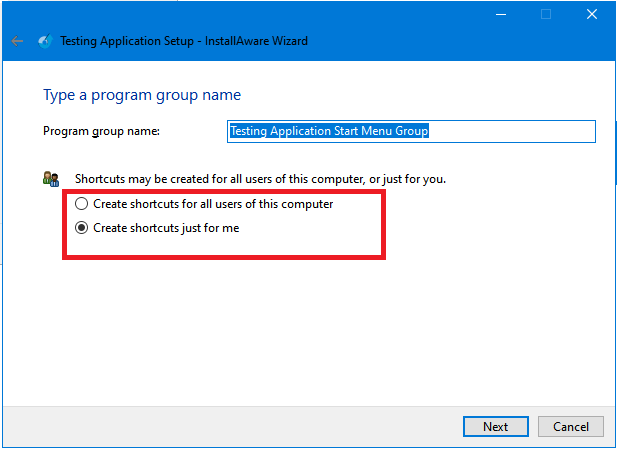

Please consider that when the setup runs interactively (not in silent mode), during the setup wizard the user still has the possibility to switch the "ALLUSERS variable" to FALSE. By default, this may happen when the "startmenu dialog" gets displayed.
To prevent such possibility you may not display such dialog at all, or you may simply modify the dialog by hiding the two radio controls (from Dialog Editor, Set the Visible property of the controls to FALSE).
