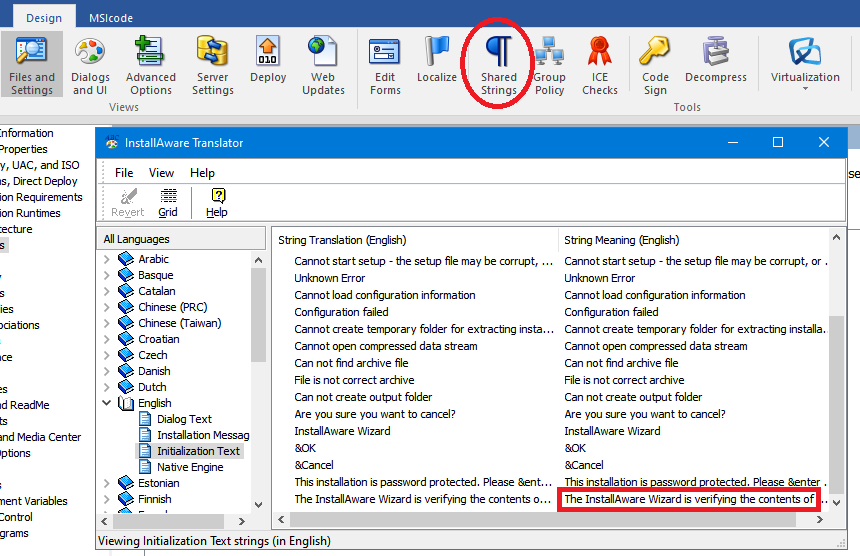

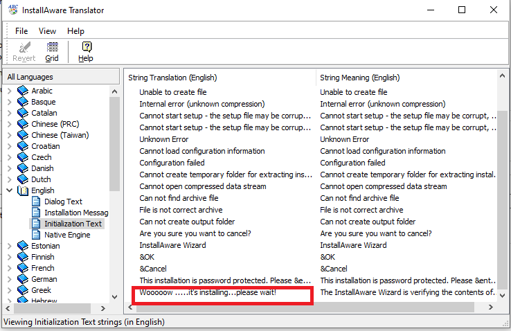

2. The text when double-clicking on the single file installation, doesn't seem to get translated. Even though I am using
mTranslater.exe in "InstallAwareX12\Program Files (x86)\trans"
"The InstallAware Wizard is verifying the contents of this setup package. This may take a moment."
I have to modify the string in translation.English.

1- From IA IDE switch to Design View, from the left tree pane select "Creatives" under the "User Interface" node. Finally, add your logo as "installaware.png".
2- This is part of the Shared Strings.
You don't have to modify any string in the in translation.English file or in any other language file.
You have to localize your setup strings.
For more details, please also refer to:
"How to use InstallAware Translation Tool"
(https://www.installaware.com/forum/view ... 772#p25655)
Localization Wizard
https://www.installaware.com/mh52/deskt ... wizard.htm
viewtopic.php?f=2&t=5048

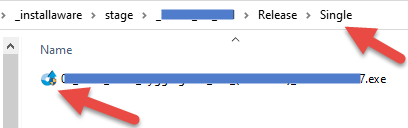

It doesn't seem to affect what I want: The very icon for the Single file installation to be customized under the 'Single' folder.
2. The shared strings
I have used the Project Properties->Localize->Export strings from project to translator..., localized the installation string to Swedish but didn't get it to work regardless. Maybe I need to reinstall/repair InstallAware X12?

Regarding the initialization string not being replaced despite translation/localization, I might have a more precise case where it doesn't seem to work:
Add a setup.bmp in Creatives. Then the translation is not displayed but still being in English.
Make sure you have some large files to be included in the installation so it is displayed long time enough to discern it.

1- for what concerns the icon, for some reasons I missed that you was referring the file icon of the generated setup package. I'm sorry for that.
The icon file has to be defined in the "Project Settings" (SHIFT+CTRL+F11):
2- Concerning shared strings, did you import back into the project your strings once translated?
did you follow the steps described with the doc: "How to use the InstallAware Translation Tool"'?
In my case, my test setup targets the English language ...and I had to customized just the English version of my shared strings.
Hope this helps you

The icon issue however, loading icon in Project Options as you showed works for CD or DVD installation exe file, but it doesn't seem to work for Single File installation exe (I have added a setup.bmp in Creatives as well here). Is this a bug or is there something I am not doing right?
For the strings, in Single File Installation, it doesn't seem to work either for any other language except English, an assumption I am making as it doesn't work with Swedish when I add setup.bmp as I described in the previous post.

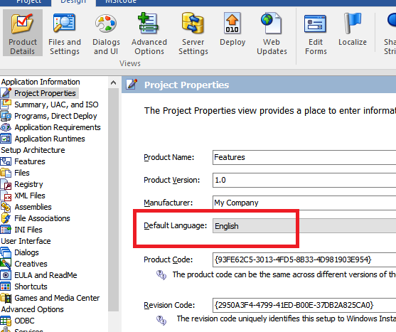

1- There my be something you are not doing right. For the file icon of the generated setup package, it's just necessary to define an icon file in the "Project Settings" (SHIFT+CTRL+F11).
2- The generated setup will use the default language as defined in the Project Settings. Did you set this to Swedish?
Then don't forget to export/import your translated version of the Swedish strings

For what concerns the localization of the "First Initialization dialog", and exclusively for what concerns this dialog only, its behavior depends on the target OS Language. So in your case, you should run your Compressed EXE on a Swedish target OS. I just did a test and works as expected.
Regarding the icon of the generated Compressed EXE, I can only suppose that this may be due a problem with the icon file you assigned. For example, I used the one attached (it's a compressed 7zip archive)...and it works fine.

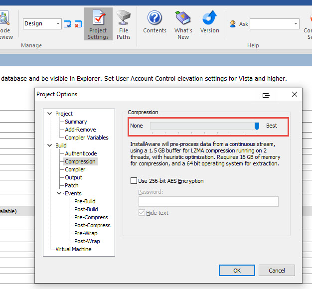

I think I figured it out now what causes the customized icon to be replaced by the default in Single File Installation. Could this be a bug unless there is something with compression settings I am missing?
If the compression level is set to the max, the icon is not being customized. As soon as I drop the compression level to a lower, I see it displaying the icon I customized and expect. A confirmation would be nice.

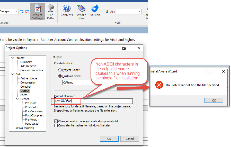

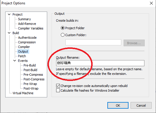

The second issue which I also think might be a bug is the non-ASCII characters in output file name.
I tried to "overcome" this problem by building the installation with the output filename containing only ASCII and then add the produced single file installation with non-ASCII (ÅÄÖåäö) I omitted during installation build, but that didn't work. In certain Windows OS-versions, it caused similar problems still and the installation didn't complete.

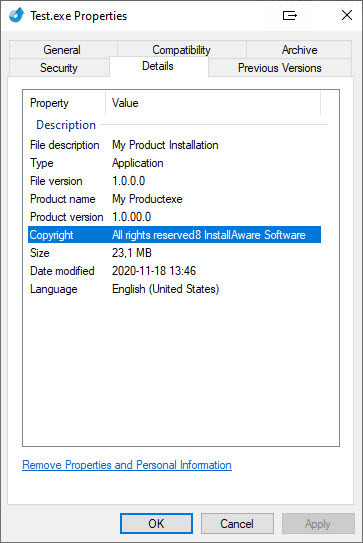

This compression setting also made me to look at the earlier post I sent:
Remove InstallAware branding - viewtopic.php?f=2&t=11291
When the compression level is maxed, it also causes the Copyright field to get garbled
'All rights reserved8 InstallAware Software"
Now I start to wonder if this max compression level might cause more severe issues then the ones I am observing?
Yes, unfortunately it seems to be as you say. I just escalated the problem to our dev team, and at moment, I cannot anticipate any time frame about the resolution of the issue, nor if a fix will be available. If you are on Gold Support subscription, you may contact us for all additional support options available to Gold support subscribers.
I don't understand from where you get such characters, honestly. These appear to be rather garbage characters.
InstallAware full supports UNICODE, consequently as you can see by my screenshot, I'm using Chinese characters (non-ASCII characters) with the file name ...and I don't see any problem.
...and then, this is the generated output
Unfortunately, it's true. I escalated this issue as well.

Regarding the non-ASCII characters in output filename for SIngle File Installation:
There is no problem to produce the file containing non-ASCII characters.
But try to run and complete the produced installation successfully. That doesn't work for me with compression level set to max. I have used Swedish characters 'ÅÄÖåäö'' to illustrate the problem.
I have attached a video. A confirmation whether this is a bug or by design would be appreciated.

This has been fixed by the latest IA x15 minor update v.32.22.
- Highest compression self-extractor icon could not be customized
- Highest compression self-extractor resource strings unterminated
