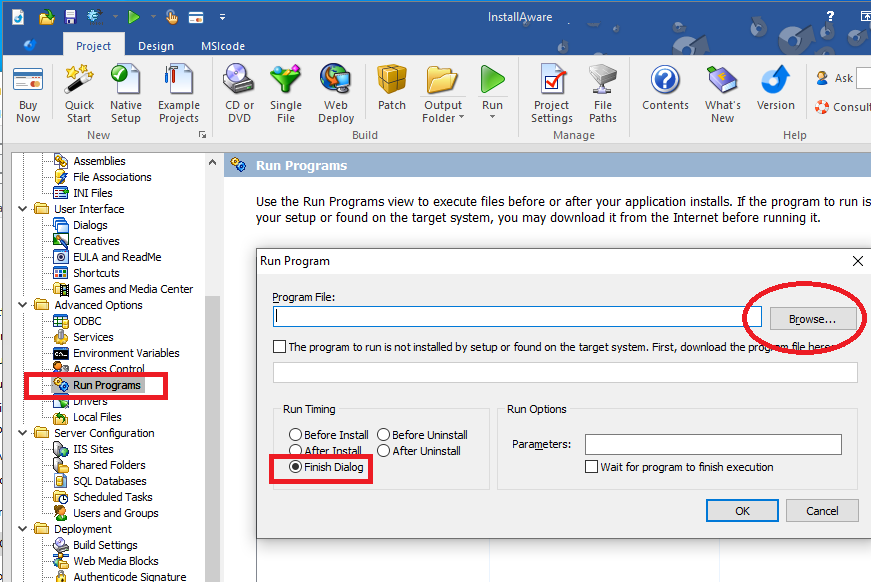

From the IA IDE, switch to Design View, then from the left tree pane select "Run Program" under the "Advanced Options" node.
Finally define which program you want to run as a part of your installation process, and also select the "Finish Dialog" in the Run Timing options. The two-way integrated IDE will update the script code accordingly.
