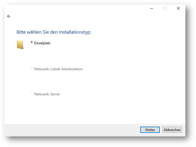

the attached screenshots illustrate the problem:
while the transition to the next dialog is not completed the controls appear correct,
when the transition is completed the radio button circles are broken;
this also applies to the checkbox in the finish dialog (too small and misplaced).

The version is X9.
By "transition" I mean the effect of sliding the next dialog window/page into view (in 02.png you can see part of the previous page), how can I disable this?

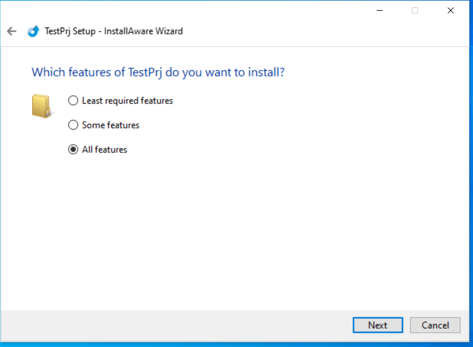

Re: DPI and Scaling
This screenshot is from a 4k Display with a scaling factor of 250. As you can see, it works fine.
I used X12 to generate the setup package.
You may do a try using the x12 trial.
