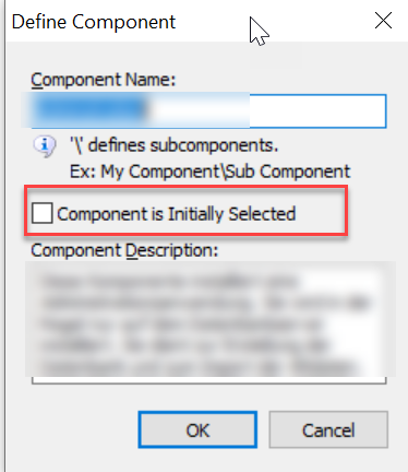

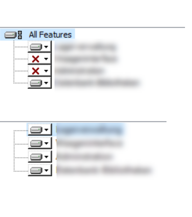

we are working with InstallAware X12.
Current problem: the initial (un)selection of components is ignored during runtime.
The screenshot shows the components at design time above and the result of the build setup at runtime.
The definition of the second and third component was edited with the definition dialog:
What is my error?

Postby FrancescoT » Mon May 31, 2021 10:32 am
A feature can be also selected/deselected using the "Set Component State" command.
I may suggest you to check if any "Set Component State" has been defined successively the initial "Define Component"
