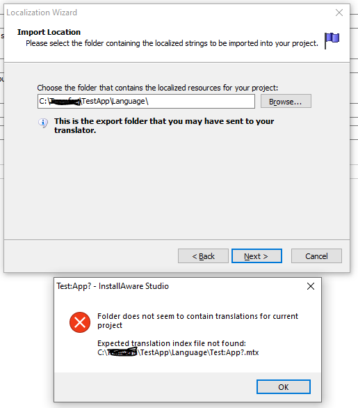

Running the localization wizard in InstallAware, also breaks with an error if product name contains a colon.

Thank you for your answer. But it does not resolve my problem with the mtx-file when setup should be localized.
InstallAware names the mtx-file identical to the project name. If project name has special characters it can not be localized.

I see what you mean.
Unfortunately the Localization process uses the assigned project name when generating the MTX file...and there isn't a workaround for this.
