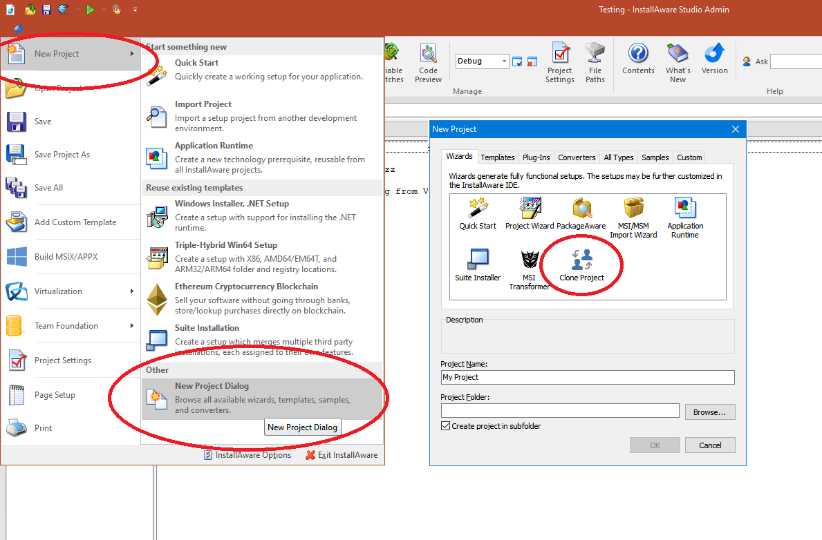

If you are on IA X13, you can use the "Clone Project" wizard.
Clone Project.
This wizard clones the active project into a fully independent new setup, with all dependent Include Scripts copied as local references found inside the new project folder."
This option is available from the "Wizard" tab of the "New Project Dialog".
