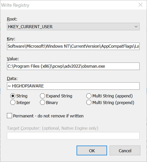

Thanks... I don't do much registry coding but I gave it a go below...... any help is appreciated.
So would the write registry command be something like the following. See attachment or copied command below.

HI...
I wanted to control the "highdpiaware" compatibility settings in the registry for the local user and got it to work with the following code.
Write Registry Key HKCU\Software\Microsoft\WindowsNT\CurrentVersion\AppCompatFlags\Layers\$TARGETDIR$\obsman.exe, ~ HIGHDPIAWARE

Now I am trying to do the same for ALL users so I tried by writing to the HKLM registry using the following...
Write Registry Key HKLM\Software\Microsoft\WindowsNT\CurrentVersion\AppCompatFlags\Layers\$TARGETDIR$\obsman.exe, ~ HIGHDPIAWARE

THE Problem is that it does not update the "correct" location but rather updates the settings in the registry under a WOW6432Node folder.
i.e.
Computer\HKEY_LOCAL_MACHINE\SOFTWARE\WOW6432Node\Microsoft\Windows NT\CurrentVersion\AppCompatFlags\Layers
which is NOT the correct location and does NOT affect the highdpiaware setting for the executable referenced.
BTW... if I manually change the compat setting for all users .... it does show up in the NON WOW6432Node folder.
Does anyone have any ideas on why this would occur and how I can fix it to write to the correct NON WOW6432Node location??
George
