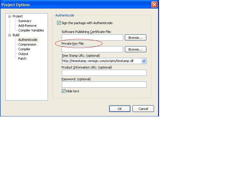

Hi
Please find the attachment.
Refering to the above post, when i mentioned PFX file, i refered to the location where it says "Private Key File". so i loaded a .pfx file.
If i'm wrong please let me know how to go about the certificates and the Authenticode cause i need to get this working.
- Posts: 3452
I believe some certificate vendors provide instructions on conversions. Just contact their technical support for help. They might even be able to mail you the files in the correct format.
