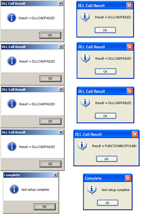

I added some messageboxes to the test project you provided. I was getting interesting results in both XP (pictured right) and 2k8 (on the left):
I did verify the function existed in the dll (through DLL Export Viewer), so not sure why I'm getting these results...

Post by mills »
What result are you getting for the failed call?
