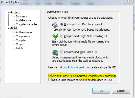

Postby mills » Mon Aug 16, 2010 1:44 pm
You can control this behavior with the "Always Cache Setup Sources" options in the Project Options:
Pressing F1 on that screen brings up the context-sensitive help, which states:
Always Cache Setup Sources (enables easy patching)
This three-state check-box lets you control setup source caching. When the box is filled, the default source caching option (as described above for each build type) is in effect. When cleared, setup sources are never cached. When checked, setup sources are always cached.
Caching setup sources consumes additional disk space on the target system. This loss of space is partially offset by the usage of NTFS compression if the target file system is NTFS. The advantage of caching setup sources is that when a patch is being applied, or when setup is being re-run in maintenance mode without the original installation file or media, setup will never prompt for the original setup sources - patching, or repairing/adding new application features automatically.
When setup sources are not cached, no disk space is wasted on the target system for a copy of the installation files. However, running setup in maintenance mode (other than uninstalling the application) will require access to original setup sources, as will patching setup.

Postby NickDay » Mon Oct 06, 2014 8:04 am
I've had a similar problem. In case it helps anyone, the solution for me was to recognise that the "Always cache setup sources" checkbox has _three_ states. I needed it checked, not just filled in. This has caught me out more than once, although it is stated in the documentation snipped above. InstallAware12.
