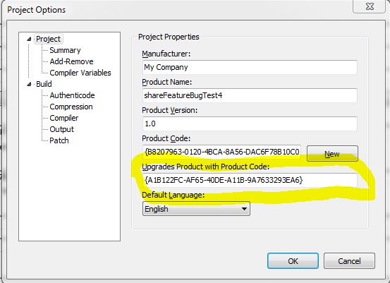

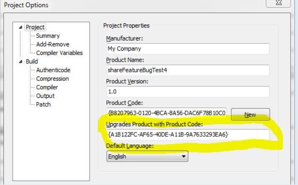

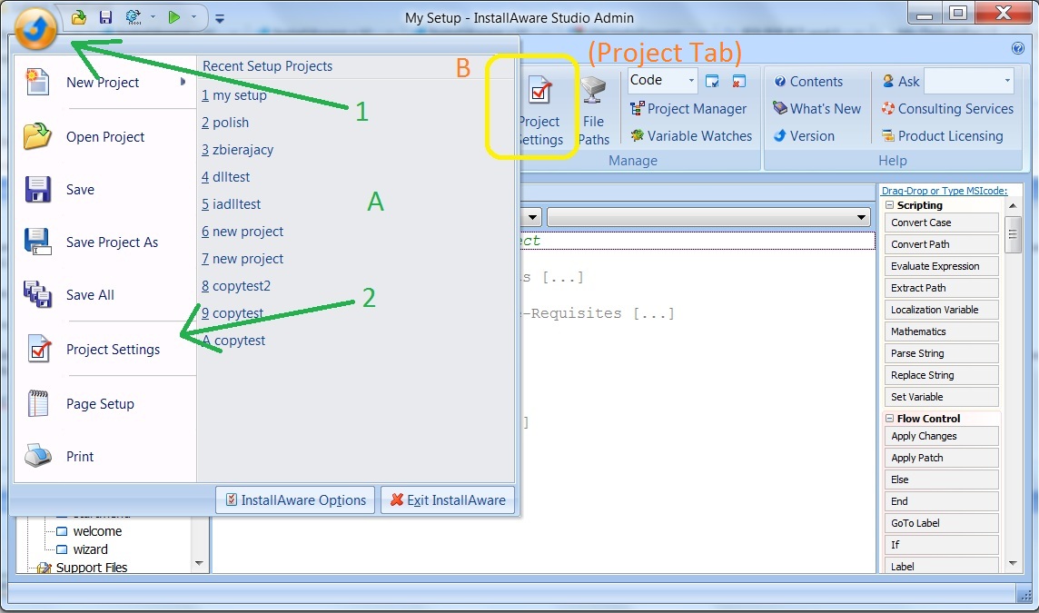

Re: Side by Side installation
Yes, your product and revision codes do differ and that is not the problem. The problem is the UPGRADE CODE is not different. You have to access the upgrade code through the project settings:
Thank you very much, Andy! This resolved my issue!
Thanks a lot again!
Thanks a lot again!

Plus I am also creating a new product key as well as the revision for every install.
The issue is similar to what is explained in this post. I was able to resolve the issue by changing the Upgrades with product code, as you showed in the snapshot.
My question is when we change a product code, this also should change, and why doesn't it change?
Is there a better way to support through script than manually changing this for every multiple install build?
- Captureerr.JPG (40.58 KiB) Viewed 16658 times
Dear kishorkk23,
it changes every time you create a new project, otherwise you must manually enter the wanted value.
Unfortunately, this value can't be handled as variable script.
It could maybe possible to assign it using a compiler variable (... I never tried) and you should manually enter its value anyway.
- Posts: 73
Thanks. Can you let me know which compiler variable can i use for this? or how can i create multiple instances without getting the error mentioned in the post.
When we say multiple instances, each instance should be independent of each other, whether it is install-wise or uninstall-wise.
Is there any robust process where i can refer and create multiple instances which are totally independent of each other...
Dear kishorkk23,
It doesn't exist any pre-defined variable ... you should define your own compiler variable for that.
As I said previously, I never tried to assign the UpgradeCode in this way ... so I am not sure that it can work.
If I haven't missed your question about multiple instances;
you could create several independent projects, each one with its PRODUCT and UPGRADE code.
Then you could embed all the generated setup packages with another installer project, where the user can select which package to install.
