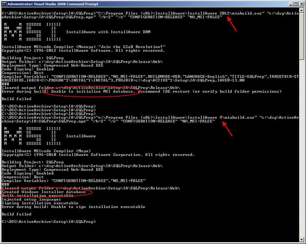

Any update on this? I have the exact same issue after upgrading from 9r2 Studio to 2012 Studio. Thanks.
- Screen shot. Drive 'v' is mapped to a different computer that has IA v9 installed. Drive 'c' is a local drive w/IA v2012.
- miabuild1.jpg (199.21 KiB) Viewed 46079 times

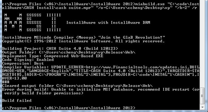

Not exactly the same, but I am encountering this error as well in IA 2012. It is my first time using command prompt build and here is my screenshot.
My OS is Windows 7 (x64). Any advice would be appreciated.
- IA Build error.jpg (69 KiB) Viewed 45952 times
