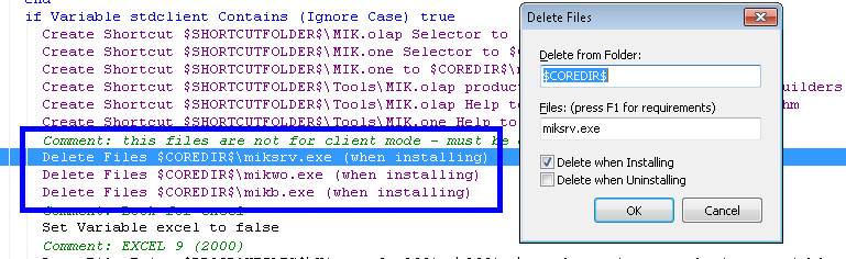

Hey Guys,
delete files (while installing) is not possible in the following constellation.
1. I Install all files from D:\installfiles\olap\*.* into $COREDIR$ (same as Targetdir)
2. Then I need to delete 3 files from $TARGETDIR$ while installing our client mode.
Result: Files are still there after installation.
- delete_files.png (20.81 KiB) Viewed 13605 times
Kind regards
Heiko Kummerfeld
MIK GmbH
Head of quality assurance
technical consultant
Heiko Kummerfeld
MIK GmbH

Dear Heiko,
can you try to be more specific, the files that you want to delete are already available on target OS or are you installing these?

I installing these and after that I want to delete a few files.
I can't install every 250 files one by one to avoid this.
