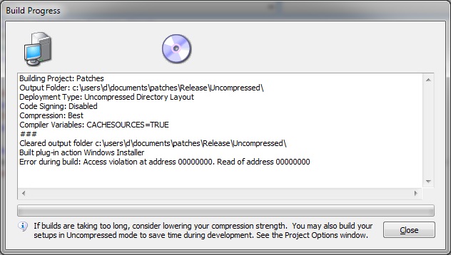

OK, so I think you were on the right track in trying to reproduce this.
By following the instructions you posted for the Unable to find saved script context for issue, I was able to reproduce this Access violation by:
Going to [installpath]\InstallAware\InstallAware 9 R2\Plug-Ins
Rename folder "dotNET Framework Runtime" to "dotNET Framework Runtime1"
Select the .Net framework 1.1 runtime.
Try to build (build type irrelevant).
Result:
Result:
