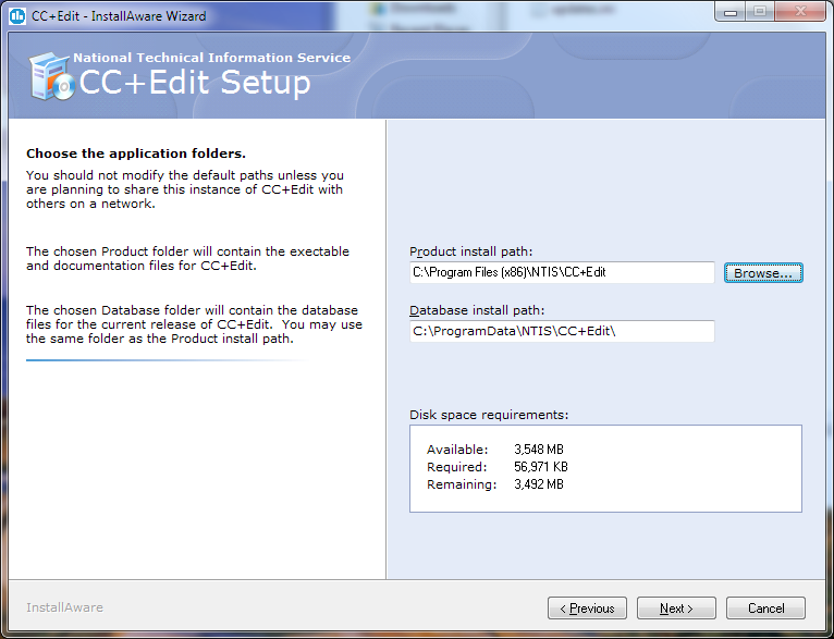

just a question, you said "This has worked for years until I added a dialog for destination".
have you tried to remove the dialog? the package works without? which destination dialog have you used? can you post a screenshot?
Re: Silent install fails via SCCM 2007
I think this is the Alpha theme. Attached is a screenshot.
Best,
Scott
Best,
Scott
- Destination dialog
- CCI Destination dialog.png (97 KiB) Viewed 14792 times
