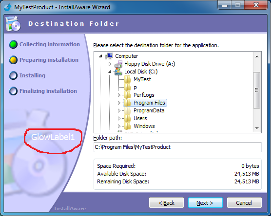

I am having an issue when setting a GlowLabel to show progress text via receiving information from installation progress. The glowlabel is set to transparent since I have a gradient background as mentioned above, but when I run the actual installer that GlowLabel as well as one or two other Label objects randomly flash white throughout the installation progress step. Any insight on what could be causing this?

Dear Hannah,
did you have any chance to send me a very "VERY" minimal project that replicates the issue?
