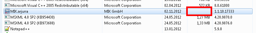

EDIT: SOLVED but...how Can I show the Size in Program and funtions (system panel)
so I need to write this content to the variable in the code, not as compiler variable

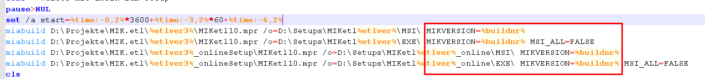

Re: Project Properties | Product version as variable
the version number of the text file should be read and saved when I build the project...that would be nice...
But I solved it like that..read the version number in batch from text file...assign the version as parameter from miabuild
and in the product version field in GUI i set #MIKVERSION#...it works
Addiotionally I add our text file as SUPPORTFILE...so I can ask for it at runtime
I do that in every of our 26 Setups
