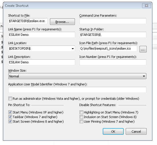

Additional info - shortcut settings.

Dear Michaels,
I have executed a quick test using an already builded package that I have and with this, it works fine.
Let me verify replicating your exact shoutcut settings and I will be back to you as soon as possible.

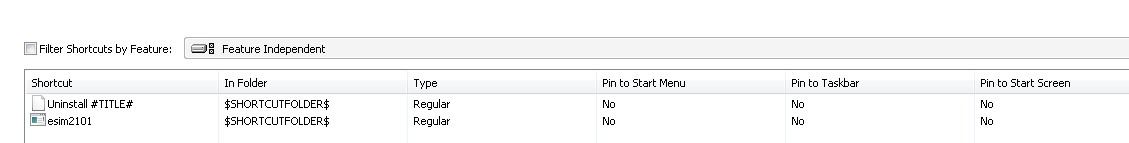

The issue is caused specifically by the 'desktop' shortcuts set up as part of the project in the Shortcuts section. If you remove all shortcuts related to $DESKTOPDIR$ and install using shortcuts in the $SHORTCUTFOLDER$ then the problem does not occur. See example below of working set up.

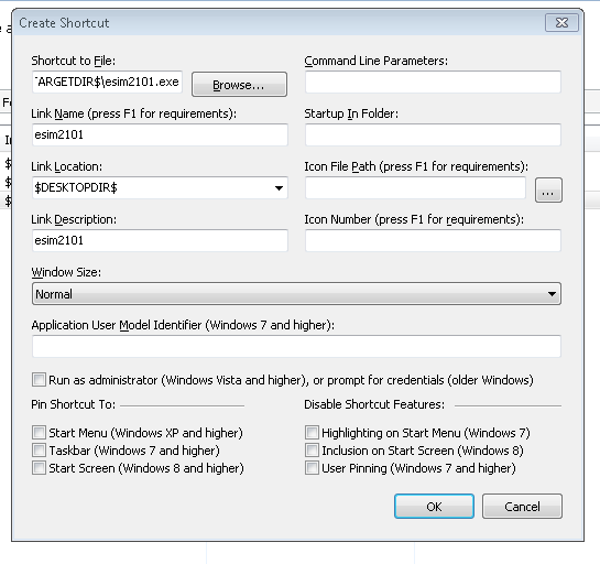

Here's an example of $DESKTOPDIR$ shortcut that causes the error. It doesn't seem to matter if I specify a Startup in Folder, Admin privileges, pinning, etc. It will always cause the Warning 1910 error message regardless of the options selected.
Is it possible there is something wrong with the registry values/settings that are written/removed on install/uninstall? Seems peculiar as this PC is Win 8 Pro, same as the other Win 8 PC we tested, and the only major difference is that it is logged in using a Windows account set as 'Network Admin', whereas the other user is 'Domain User'. Accounts seem not to matter as we logged in on both PCs using various accounts and problems still occured on the PC with errors, regardless of the account. Both computers have no security software, etc. as they are test computers so we can rule that out.

I have done the same and works fine.
I have tried everythings ... with or without pinning options.
I don't think that can be caused by the account or domain settings.
I am really out of ideas.
