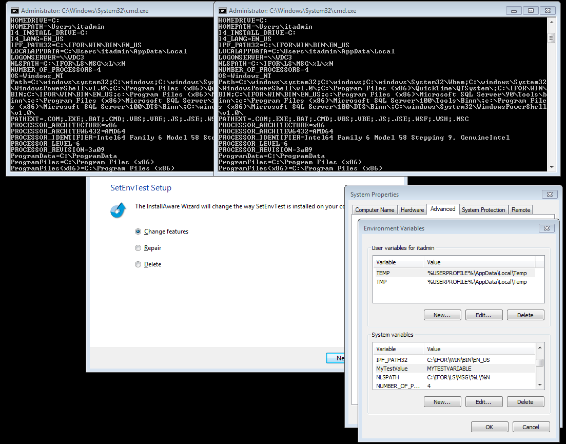

Since I can not convince you with words I attach a screenshot after running your pre-compiled example twice (\Realease\Single).
As you can see the variable is not set in the second CMD-prompt, newly spawned processes do not see the changes IA made to the environment.
And no, I haven't photoshopped this :-)
I can reproduce this (using your binary) on both English Win XP x86/7 x64 on clean machines coming right out of MDT 2012 deployment with no software preinstalled.
Also: Considering I am not the first to report this behavior (see links in my first post) I hope I can convince you to look into this?
If I modify your example project to include the SendMessageA I posted above and place it after "Apply Install" and recompile it works as expected.
Let me know if you need any more information for troubleshooting this.
